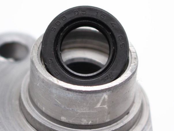

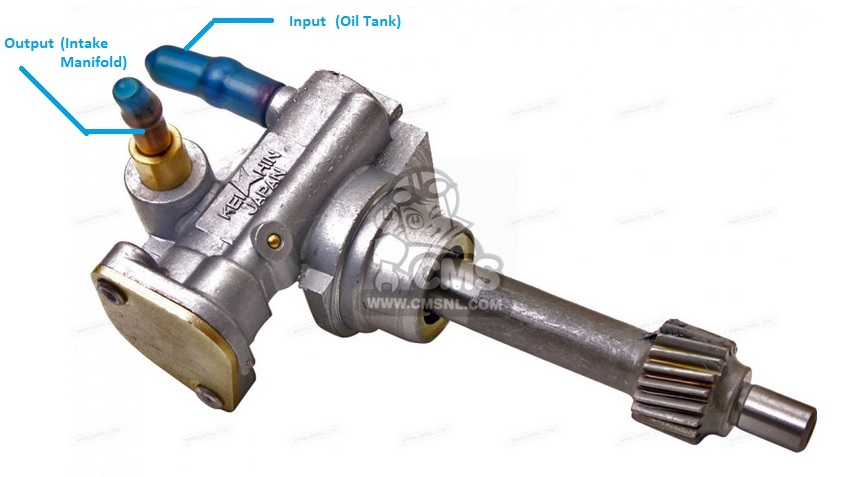

Second question, my oil pump seal is completely shot. The crankcase fills with oil after just a week of sitting. Should I just try to find a used pump on ebay, or is there a way to replace the seal with my current pump? I would rather not switch to premix.
Worth checking before replacing the oil seal:
The brass output barb pressed into the oil pump contains a ball check valve.
It is spring loaded to prevent a leak due to gravity pressure through clearances in the oil pump. When the scooter is running,
oil pump pressure opens the check valve each pump stroke.
Hook your oil pump back up to the oil tank, and hang it over two containers, one under the shaft, the other under the oil pump output.
Regarding the oil pump shaft seal, it is a rubber lip seal.
Seal dimensions are 9.5mm id, 16mm od, 4mm thick
Honda/Keihin wanted no chance of the oil seal working its way out.
The shaft seal is retained by a metal washer, then the oil pump housing is staked to retain the washer + oil seal.
Replacement is straight forwards, remove the retainer, and implement a means to retain the seal upon replacement.
The washer in the stock oil pump is visible in the photo below.
