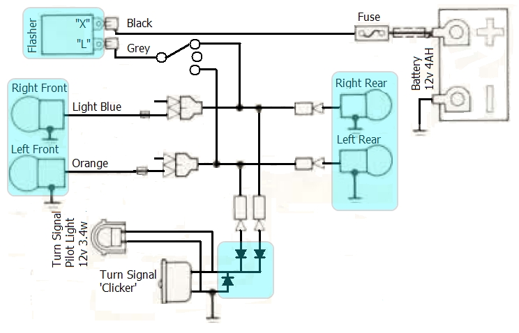

If all four of your blinkers are flashing, the flasher you installed may be fine.
The OEM flasher would not flash under the lower load of LEDs.
In fact the OEM flasher will not even blink on a side if one bulb is open.
-- Why do all four leds light up?
When all four LEDs are flashing, it is because of two components,
1) The Filament of the turn signal indicator on your dash is wired in between the left/right blinkers
2) The Turn signal 'Clicker' is wired the same way
What makes all four LEDs flash, is the the activated flasher (We will use the right blinker...) Applies
12v to the Right LEDs. With the Turn signal indicator and Clicker wired to the Left LEDs, the Left turn signal
channel forms the ground.
With Filament bulbs in the OEM circuit, the current flowing into the Left channel is not enough to light up the
Left bulbs.
But with LEDs, The Left channel lights up along with the Right.
-- Fix ideas (others may have additional methods to post)
1) A crude method to fix the problem is to put resistors across the one of the Left and Right turn signal bulbs.
2) Diodes as you mention is cleaner, and gives the best power savings. I converted years ago, when
Leds were expensive and low power. My Leds are 3 watt. So I used 1 amp diodes, leaving about 1/2 amp margin.
-- Diagrams
This is what I did when converting my Gyro and Elite 50. The Spree is basically the same wiring.
Original turn signal wiring
Modified wiring diagram

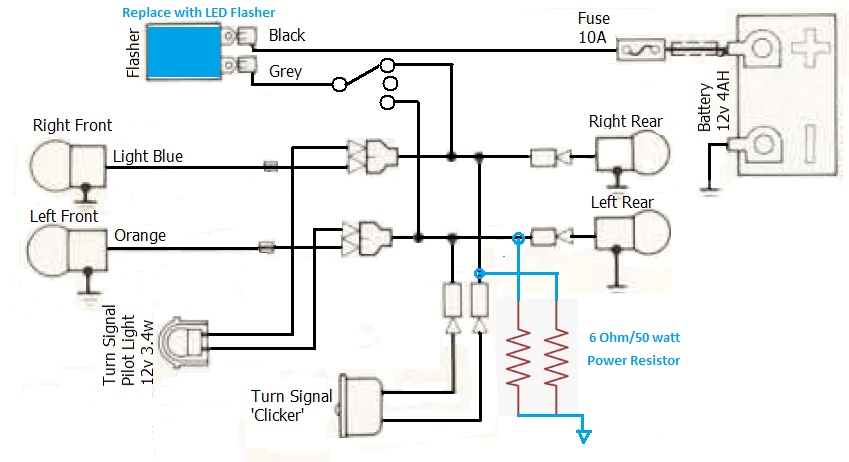

All four of mine just stay on. I’m not very worried about power savings I just want them to blink accordingly. What the simplest way to achieve this. I still have the original flasher relay right now.. c
You can add load resistors to simulate 2 Lamps. But with today's high power LEDs the resistor does not to draw as much power as 2 lamps.
Post your LED wattage or current and we can give a go at sizing the load resisitor.
It would be well worth your while to switch to an LED flasher, to reduce amount of turn signal current burnt in the load resistors.
With the OEM load and a weak battery often times the blinkers do not flash when you are stopped.
Below diagram shows resistors sized to 1 lamp load only. It will not flash with the OEM flasher.
But in the short term just run 1 LED and 1 filament lamp on each side.
Later you can replace the flasher with an LED type, and upgrade all signal Lamps to LEDs.
GyroFlasherWiringDiagram - LED load Resistors.jpg (80 KiB) Viewed 13008 times

I finally got LED blinkers working on the rear of the old spree . My question is how hot do they resistors get.? I got the tiny aluminum fin ones that i screwed underneath the frame away from anything. When I do the front I wanna know how to safely place the resistors … thanks
Not sure what you installed. Post up what you used for resistors.
The 6ohm/50 watt resistors I posted would draw the same watts as an OEM lamp, and would get about as hot. If you keep it an inch or two from plastics and wiring it should be fine. The average power is only about 12 watts. In comparison, a sewing machine lamp is around 15 watts, You can see they have only an inch or so between the lamp and plastic housing.
