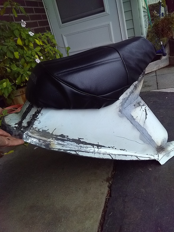

Here is what i've made so far for below the seat.

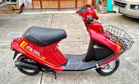

Here is the stock photo.

I have a not-for-export 1983 Honda Flush that came without body panels, meaning the one(s) below the seat and above the front wheel. I've looked at stock photos and from the shell of a hot water tank with 50 gauge steel, made a body panel for below the seat. Welded it up, now need to use filler, sand, and paint.
This leads to two questions: 1) how does the rear luggage rack attach to the frame beneath the seat (you won't own one of these Flushes but may have ideas)? and 2) how to build the front panel that includes the headlight, front steering column and area above the front wheel?

Thanks for the front view of your blue Elite that is more square and flat than the stock Flush photo I was able to find. I want to build it round, bulbous that it is, which also ranked it as one of the ugliest scooters. The only visible points for attachment to the frame are the bolts on either side of the headlight.
