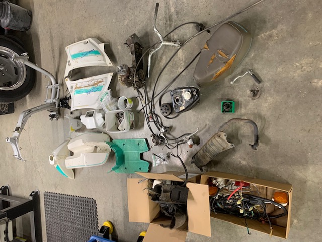

I can't believe it's been 4 years since my original post on my Lollipop Green Spree. It has been sitting in my basement untouched all this time, other projects always seemed to have priority. But I have finally started the restoration. I think it would be fun and helpful to document the restoration on this forum, so should I post this on "Scooter Showcase" or "Builders Workshop"?

I did make sure it started before I started taking it apart which tells me most of the electrical components are good. I don't think the auto petcock is working so just plumbed around it for the test start. I've got a new one on order. The electric start works ok, but the manual kick start needs some attention, probably a good cleaning and lubrication.

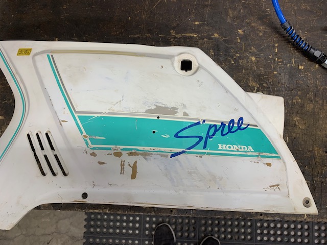

My biggest challenge is going to be the body panels. Some are in rough shape and will need some work. Based on what I've been able to find out so far these are ABS plastic which will require proper preparation in order to paint them. Any advice on this would be appreciated. I'm going to talk to the owner of my local paint supplier, who I know well, about what it takes to paint things. I've got the paint codes for both the Shasta white and Lollipop green.
I'm doubtful of finding any decals so I'll probably paint the pin stripes and other green areas and have some decals made for the "Spree" and "Honda" lettering. I think I can make the other small labels. But, If anyone knows where I can get decals, I'd like to know.
So far, I haven't found any major issues, just a lot of cleaning to do.

There appears to be two different types of material used on the body panels. The front fender, front spoiler and the floorboard are the very flexible plastic that has the color through and through as mentioned above. I'm going to talk to my paint guy and see what it will take to restore these.

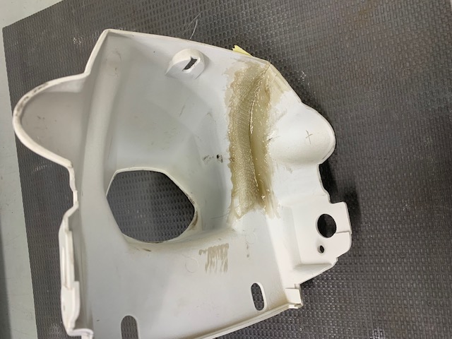

The side panels and the two handlebar covers are some type of composite material with a color layer on top of the brown composite. One of the handlebar cover pieces was cracked so I'm experimenting with fiberglass cloth and resign to repair it. I sanded down to the brown material on the inside and applied the fiberglass to that. If that holds then I'm going to sand the outside and spray a coat of epoxy primer. If that holds then I treat them like fiberglass panels.
