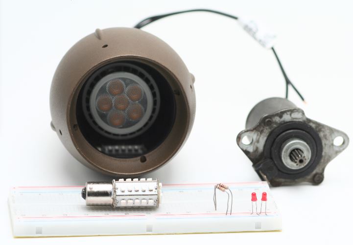

The flasher was tested with 4 loads
  1. Minium Load 500ohms + 2 LEDs in parallel - Approximately 0.02A to test the MFG's low end spec
  2. 1 Turn signal LED -
  3. 1 50 watt equivalent white LED lamp. It has an internal regulating supply so is a more complex load
  4. 1 Spree/Elite headlamp with both filaments lit. 25 watts x 2. Simulates the incandescent load of using this flasher with OEM turn signal lamps
  5. Starter motor on a bench supply. A 15 amp current limit was set on the power supply.
Load Test results:
All loads were flashed properly. The starter motor briefly drew just under 15 amps each time it started. At the end of a few seconds of pulsing the motor, the power transistor within the flasher was barely warmer than finger temperature.
Minor nit: In the 0.02A light load test, the LEDs give one very short blink at startup.

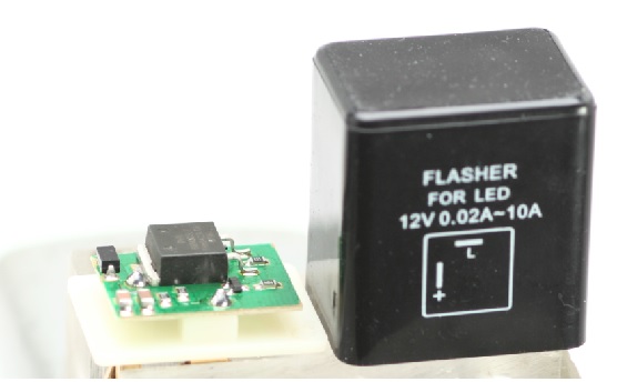

Teardown
The flasher is easy to open, there is no potting, glue or plastic welding on the case.
Inside is a single sided surface mount PCB.
Detailed view

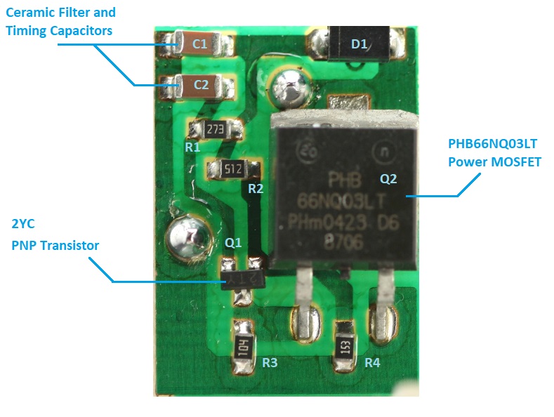

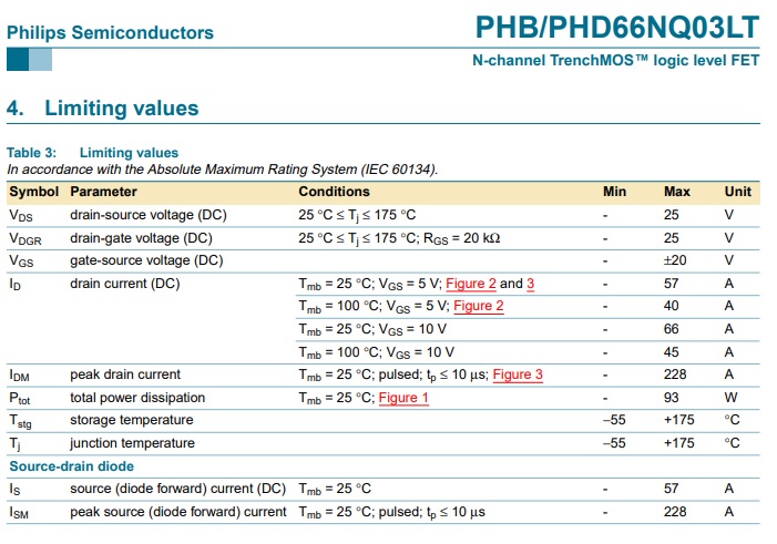

Re: Electronic 2 Pin LED Flasher Test
Posted: Sun Mar 13, 2022 1:13 pm
The Flasher switching device is a power MOSFET which will handle LEDs easily as well as the Incandescent lamps in our scooters.
There is no heat sink required at the 10 amp max the company lists. As noted with the starter motor, the device stays cool to the touch.
Some of the power MOSFET specs are shown below.
Note Incandescent lamp turn on draws many times the load once the lamp is lit. That makes the high current rating a required element of the design.
One other component choice to note is the filter and timing capacitors are ceramic. They will do much better over time/temperature than electrolytics.

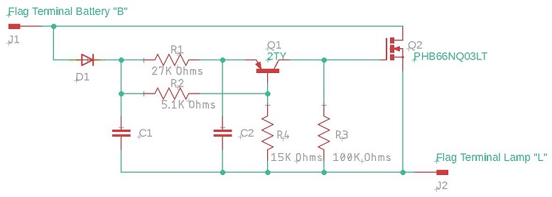

Schematic
Here is a schematic traced from the PCB.

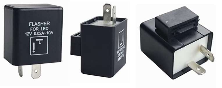

2 Pin Adjustable Flasher - Seller Photos
Specs:
'Adjustable frequency, 50 times/min -200 times/min'
'Adjustable rotation, clockwise flash speed becomes slow, counterclockwise speed becomes fast'
The flasher has a rating of 2 x 23watt lamps + 3.4w flasher indicator.
That is about what our scooters draw with OEM lamps.
The current rating is below the fixed flasher which is rated '12v 0.02A - 10A'

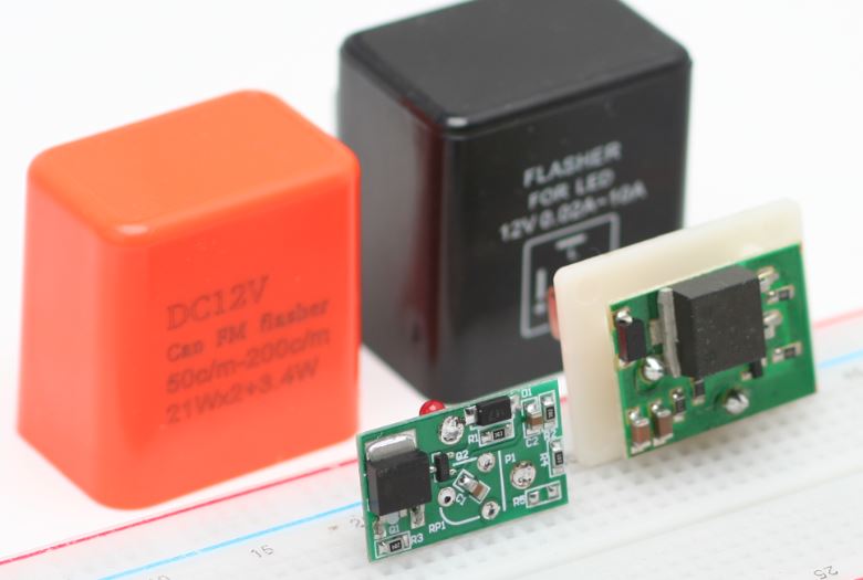

Posted: Sun May 08, 2022 11:40 am

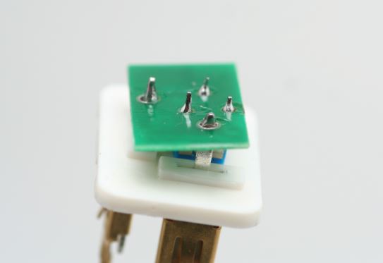

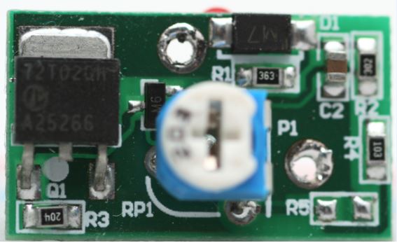

Flasher Teardown
Soldering of the PCB to the connector terminals was not heated enough to flow into the plated holes.
More on that later
Flasher Comparison
