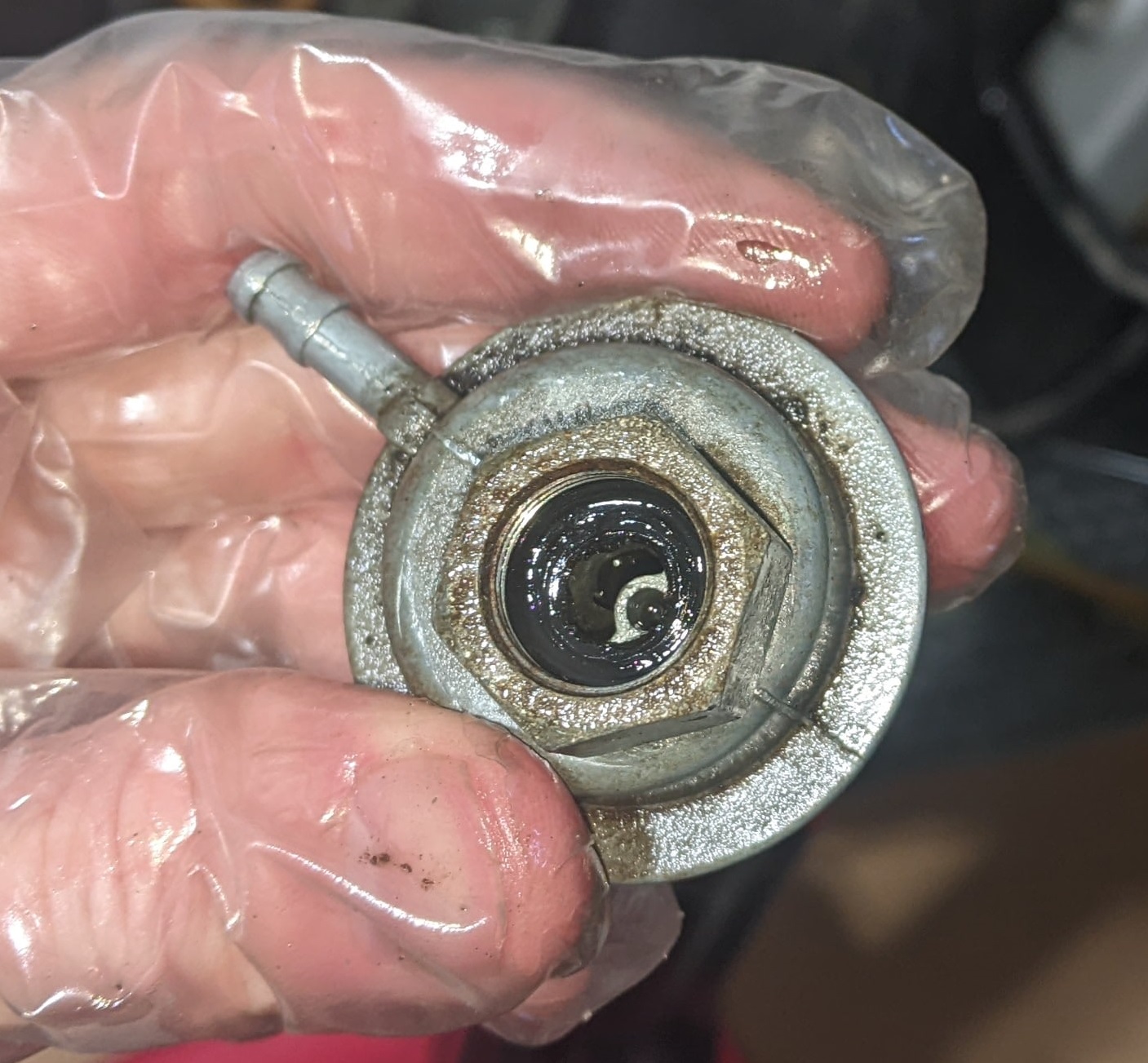

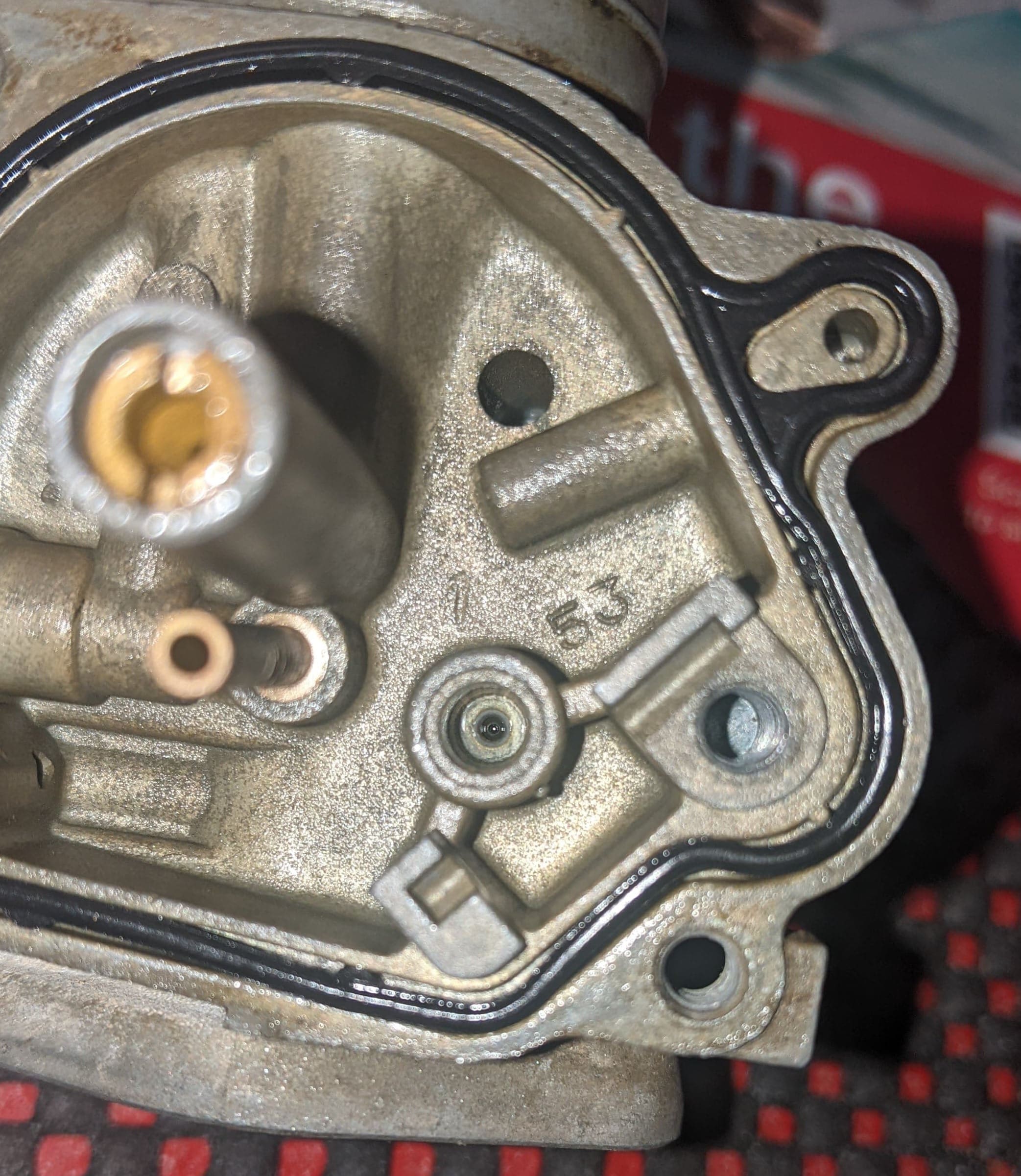

The carb float seat looks good from what I can tell. The seat issues link you shared had some pictures of what damaged seats look like and mine looks clean. The needle looks good too.
When putting the float body back in, I was careful to look that it was putting pressure on the needle when pushing up.

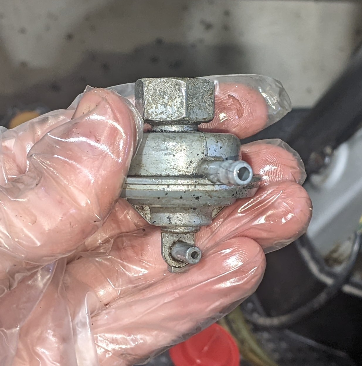

I took off the petcock and it looks like there is no way in that sucker. When looking in the hole where it connects to the gas tank, I don't see a screen. Couldn't find anything wrong with it but don't really know what to look for.
Thanks for all the help.

The wiki has a topic and teardown of a petcock. I think the case halves are pressed together, judging by the teardown pics.
http://hondaspree.net/wiki/index.php/Pe ... nd_Anatomy

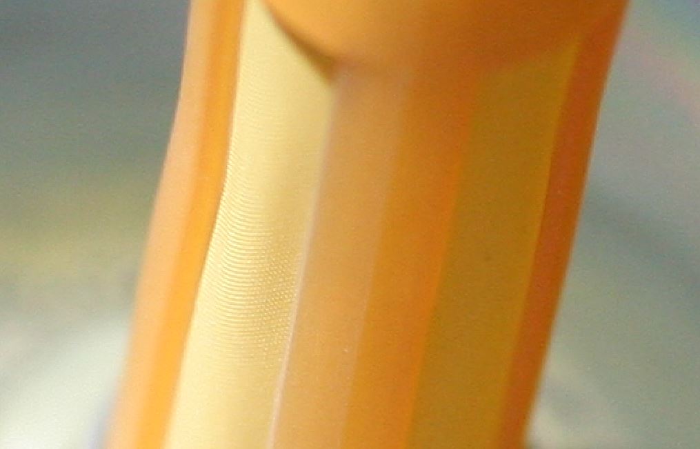

Tank strainer
No strainer in my area is a problem, as many scooters have rusty tanks. But your area/tank may do much better.
Aftermarket petcocks usually come with a screen - or an external filter could be added.
Here's a close-up of the OEM filter screen
