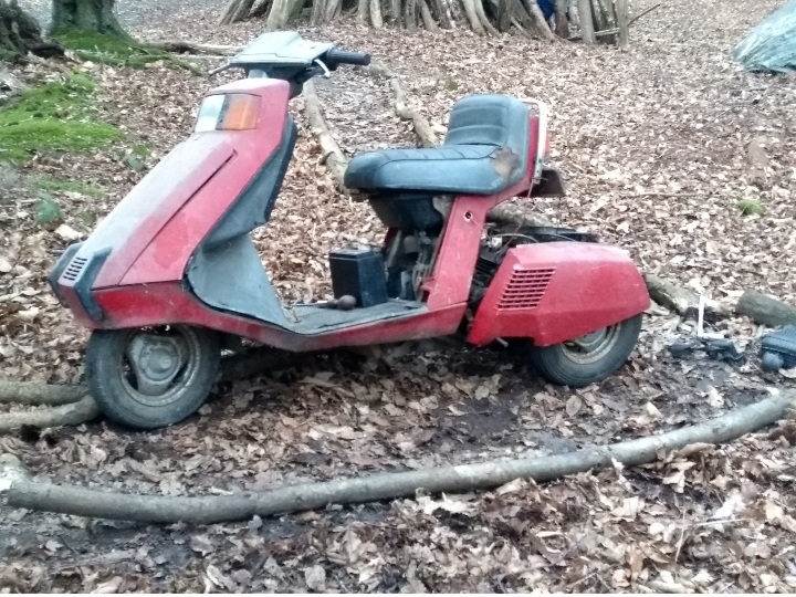

Just trying a pic
- Screenshot_20220526-092549_Gallery.jpg (204.25 KiB) Viewed 12170 times

It's an '86 registration but I think it's year of production might be a couple of years before that. I've rebuilt the top end and it starts but it accelerates very slowly upto a max of 15mph and a hill will drop that to 5pmh. I've never had a twist and go gearbox and it feels to me that the issue is there , like it's stuck in a very limited gear range. I've whipped all the gear bits off and cleaned the faces , squished the spring etc and for one acceleration it goes quite well but then gets stuck again. I thought if I could I'd cross reference the parts with the csml database and just replace it all as it seems cheap enough. But I've got no part numbers for the stream. I'm sure most of the parts will have been used on other models.
