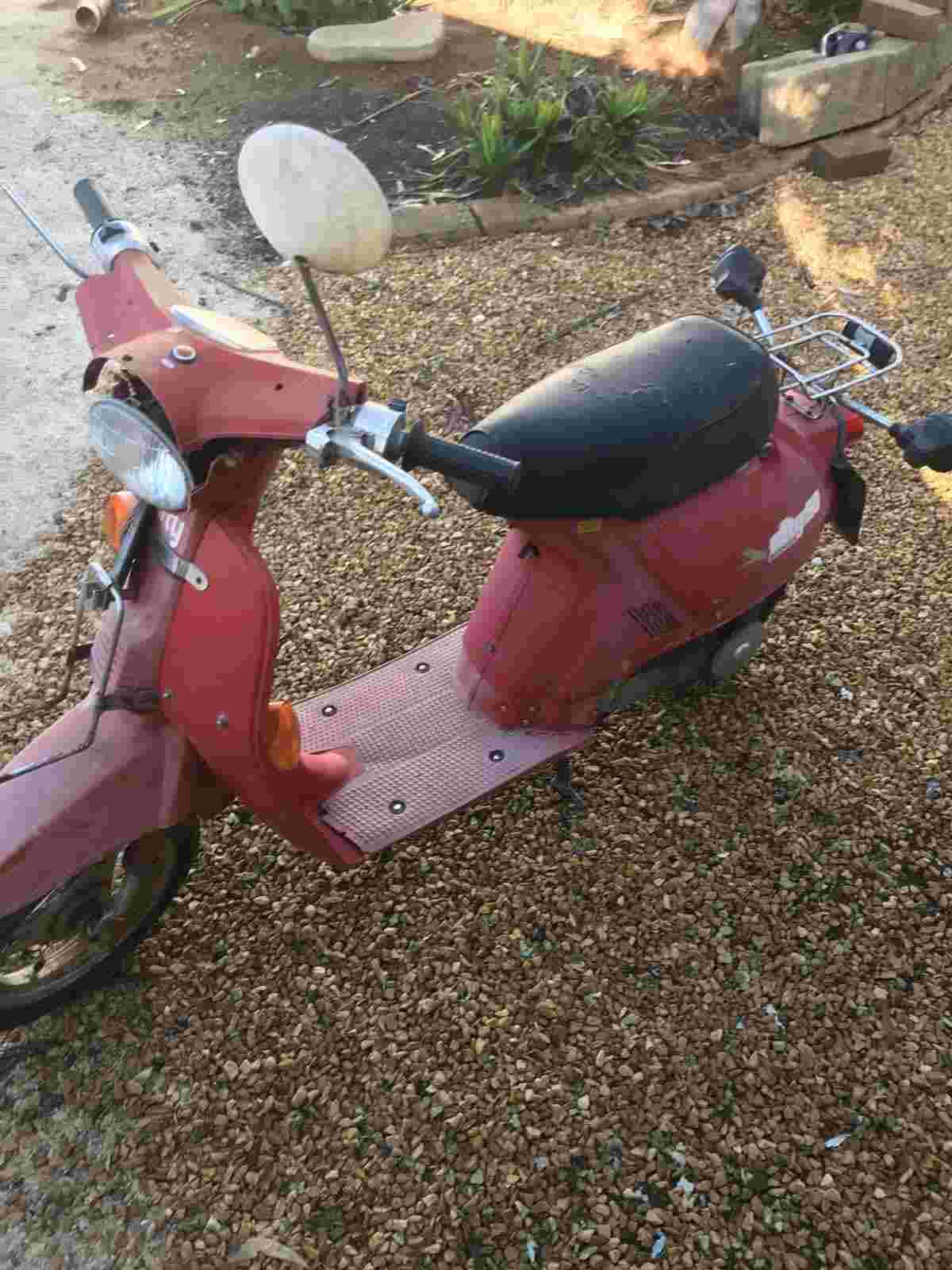

Hello,
I purchased this 85ish honda nifty 50 for $300 delivered (sight unseen) from Gumtree (Australia's version of Craigslist)
Not running
Frame broken (footwell)
Both tyres flat
Fairing /plastics broken etc
Missing parts
No licence plate / papers
So yeah. Bit off more then I can chew lol

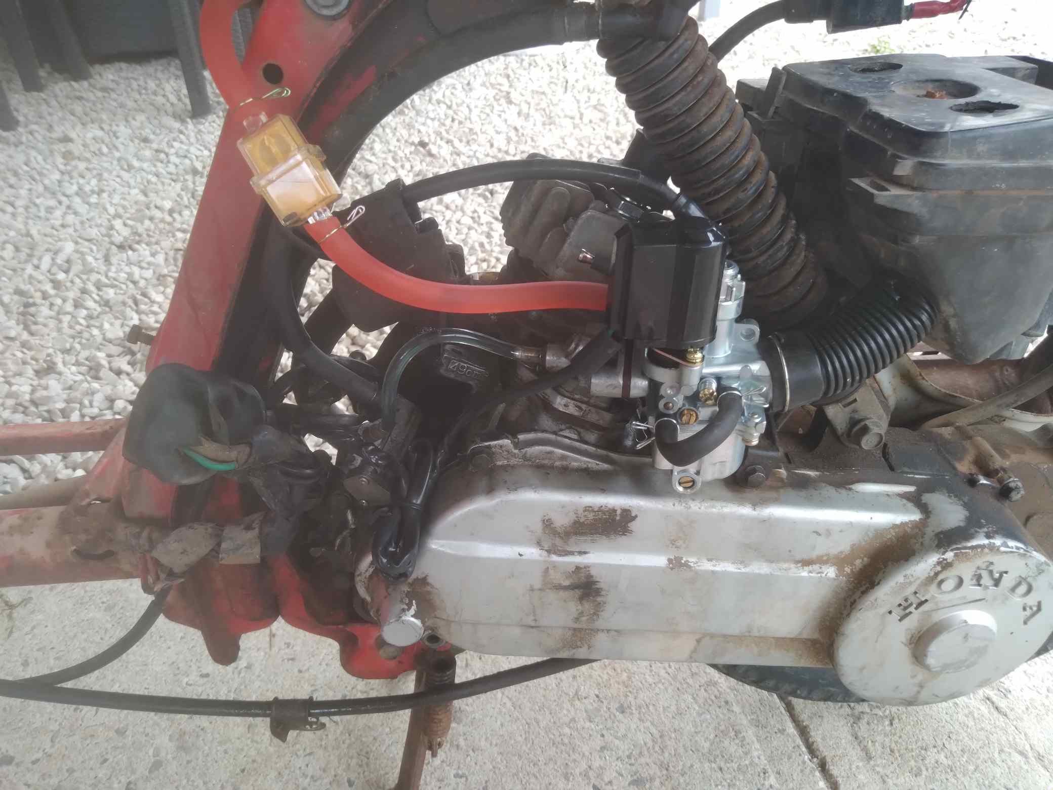

New fuel lines , filter carburettor

Also the holes in the air filter box are very rough
Are they stock?
Re: A Nifty Spree for me
Niftyspree wrote: Thu Aug 04, 2022 2:11 am Also the holes in the air filter box are very rough
Are they stock?
No, holes in airbox are not stock.
You can experiment by taping them shut, and adjusting the carb starting with a closed airbox as it would be from the factory.
Very likely you have an issue with the throttle cable as you suspect regarding the "take-off like a rocket" issue.
I notice the missing cylinder shrouds. Those covers NEED to be in place for proper cylinder cooling.
Risk of damage is high without proper cooling.

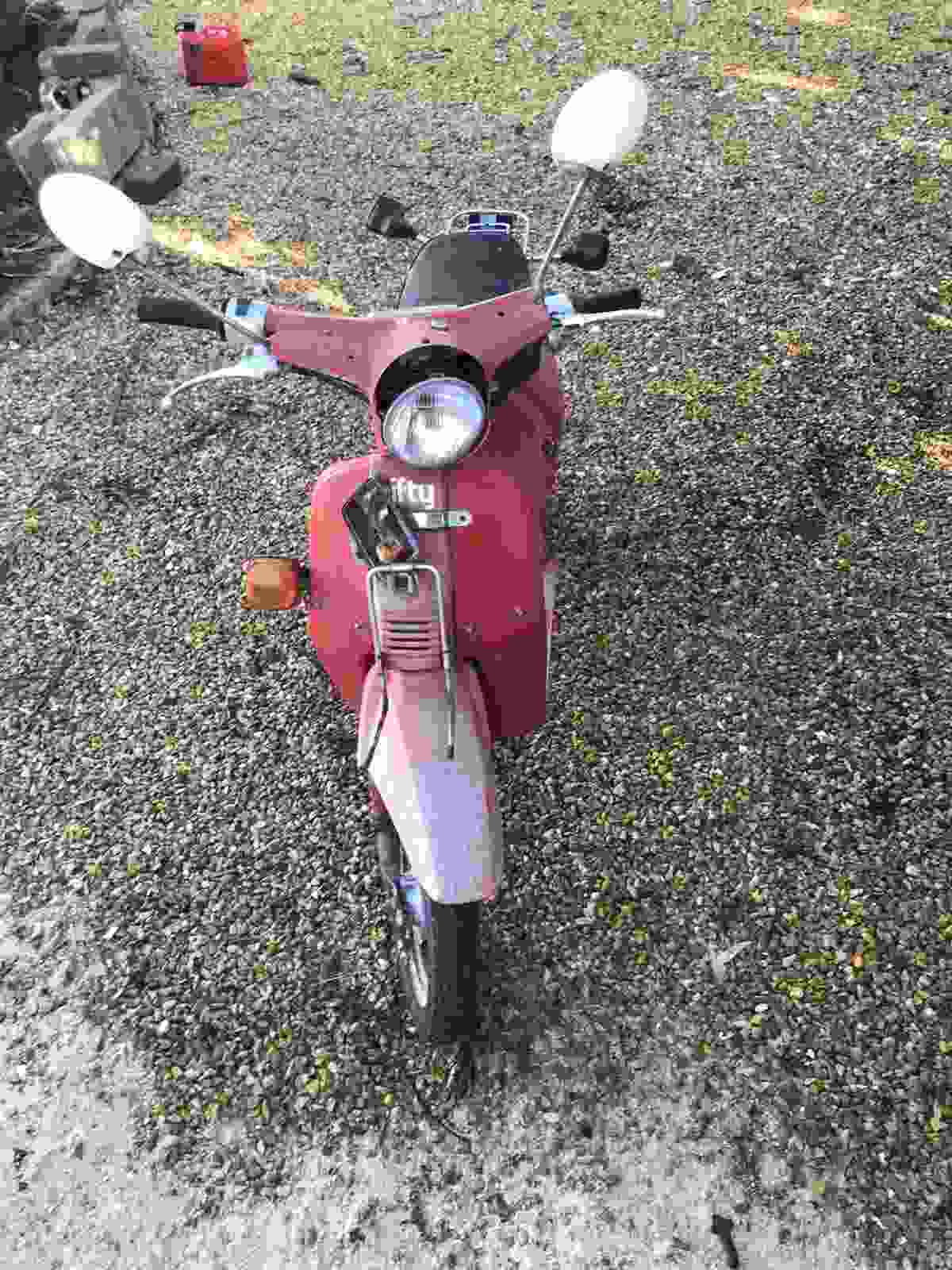

mousewheels wrote: Sun Jul 24, 2022 11:59 am I like the Nifty Fifty head plastic - wish the US got them..
Yes, mine are very "used" lol
intresting that honda did not export the exact same style everywhere.
