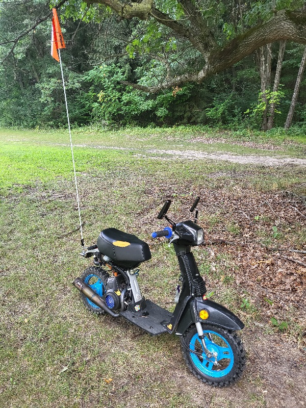

Welp... The 74 is better, she'll hit 35 when she's on top of her game! But... She still dies after a while. Longer than with the 76 though so that's an improvement! She'll start up again, but dies if I close the choke or give her throttle. I think she might still be flooding so I'm going to try the 72 again, if that don't work maybe time for a new carb. 🤷
Here's a pic from testing out on the trail by my house!
