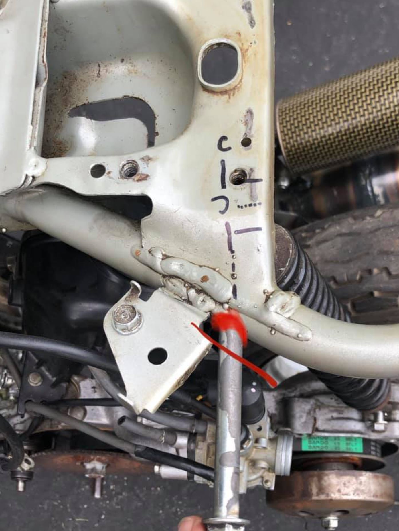

SSS sell's a bolt on kit for the rear shock mount. I have posted some photos of what I did on the FB elite/dio pages. I ended up drilling a hole in the tube frame (under the gas tank), welded in a a bolt. I will see if I can dig up some photos.
