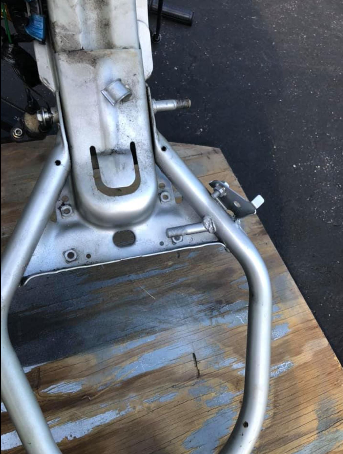

I’m ready to start working on swapping my af16 onto my 88 elite e. I have found plenty of info online about fabrication for the motor mount but I can’t find anything for the rear suspension. Can someone send me a link to a build or tell me how I should do it please?

SSS sell's a bolt on kit for the rear shock mount. I have posted some photos of what I did on the FB elite/dio pages. I ended up drilling a hole in the tube frame (under the gas tank), welded in a a bolt. I will see if I can dig up some photos.
