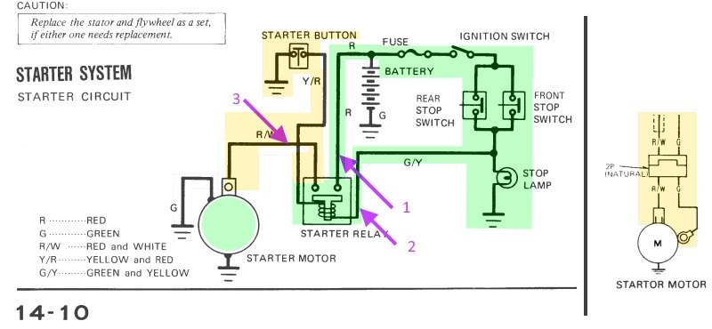

There should be +12v on 3 prongs of the relay with the ignition "ON", brake lever pulled and start button activated.
Take a look at the marked up diagram. The green is good from what you posted.
Relay pins marked as '1' and '2' on the diagram are what are lighting your test lamp.
  • Is the replacement Relay pin out same as OEM?
  • Can you hear the relay click with the start button &brake lever are a activated?
    No? Put in a temporary jumper to ground on the relay coil (yellow/red stripe wire identified as '3' on the diagram

From the relay harness when key is on I get 11.6 volts to 1 prong and when I squeeze brake I get 10.2 volts to prong directly next to it and when I press start button I get nothing on either of the 2 prongs that are on the opposite site of the 2 I'm getting voltage too. The new relay is not OEM bit aftermarket from Amazon which was the recommended one. I get no clicking from the relay.

I ran this series of test that I saw you had in a previous post.. When I connected the test light to the Yellow/Red wire on the starter relay and pulled the brake the light came on and when I pressed the start button it still stayed on. So now I'm thinking my start switch button is bad.
Connect test lamp to G/Y at the starter relay. Turn on ign, Pull either brake handle. Test lamp should light.
2) Start Button/Relay coil 'low side'
Connect test lamp to Yellow/Red stripe wire at starter relay.
a) Pull the handbrake with ign on as in test 1. Test lamp should light.
No light? - bad relay coil, broken wire connection.
b) Keep the handbrake pulled, and press the 'Start' button, test light should go off. Light on --> fix starter switch or wiring in start button circuit.
3) If the above tests were ok, put test light on Red with White stripe wire on relay output, Activate brake and start button. No power -> Bad Relay
