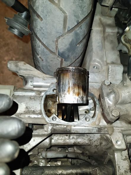

Initial conversion to china big bore kit failed in ~ 1000 km due to soft seize.

From my point of view the failure of china big bore kit was this small original carburetor that i tried to tune a lot and i have run with 97 main jet and 45 pilot jet on stock air filter box.
Usually the soft seizure appear when i let off the throttle ...

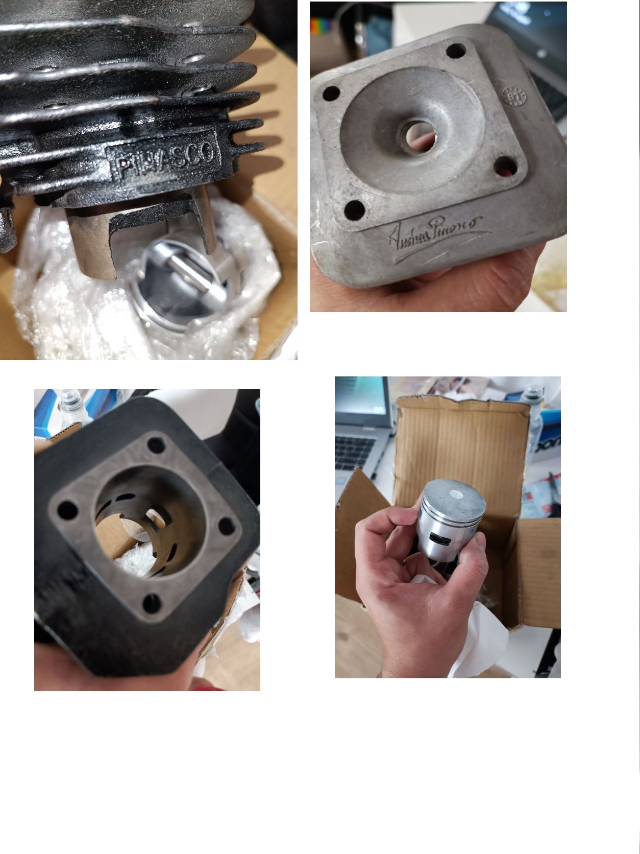

- Pinasco BBK with 48.5mm piston ( Since my kit was a NOS one found on shelf , i didn't get the rings for the piston and took me a while till i found them)
- Pinasco head that come with the kit.

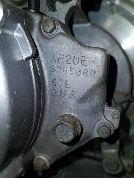

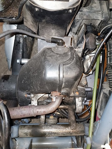

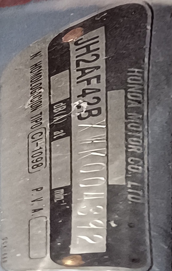

Picture 3 - engine view.jpg (104.75 KiB) Viewed 29444 times
Picture 2 - case model and number.jpg (113.25 KiB) Viewed 29444 times
Picture 1 - vin number.jpg (151.5 KiB) Viewed 29444 times
