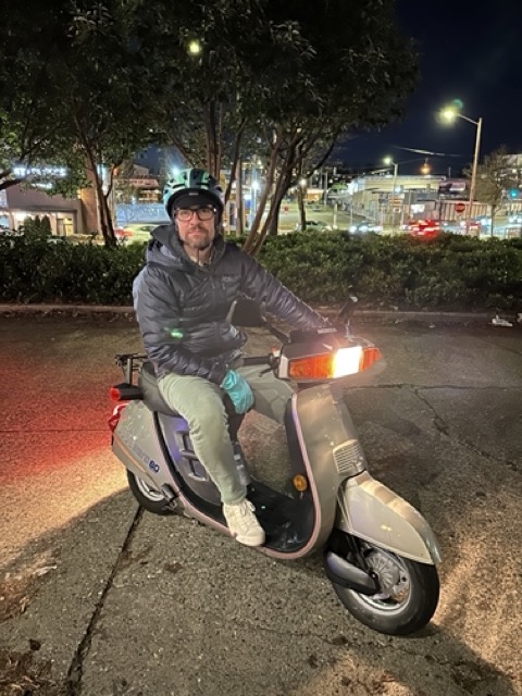

Thanks motormike and breaze for the responses! I'm Scott, 38 from Seattle.
Mike, you have the Aero of my dreams. I love that blue '85 version with the extra storage compartment.
Here's mine ('84):
Scott and Aero 80 - 2023 Medium.jpeg (120.24 KiB) Viewed 221912 times

I took the Aero out on a ride the following day after purchase, and I got about a mile from home before it sputtered out and died going up a steep hill. And I couldn't start it again, so I had to push it home. Once I got home, I remembered the kick start, and that actually got it running again. I took it to the nearby grocery store and back and nearly got home before it sputtered out and died again. Both times, like you described breaze, this seemed to happen at wide-open-throttle. And since, I've had trouble getting it started and/or keeping it running enough to ride down the block.
