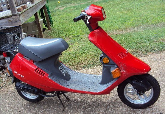

Thx for the info. I suspect the prev owner may have swapped some parts out looking for better performance but it wasn't running when I bought it. Is there an easy way to tell if the exhaust is a "P" or "non-P" version?
Re: Carb upgrade?
zz28zz wrote: Sun Jul 09, 2023 2:28 pm Is there an easy way to tell if the exhaust is a "P" or "non-P" version?
Generally, a restricted pipe will have a smaller diameter head-pipe that maintains the same diameter the entire length, whereas the "hotter" pipe will have a stepped diameter from head to muffler. I can't speak with experience pertaining to the '87 Elite SE...even though i owned one before...lol...but as you see in the pic, this pipe is restricted. I think (maybe) the '87 SE was a model that only got the restricted pipe.

Thx. Looks like I have the restrictive version but that's fine for my intended use.
