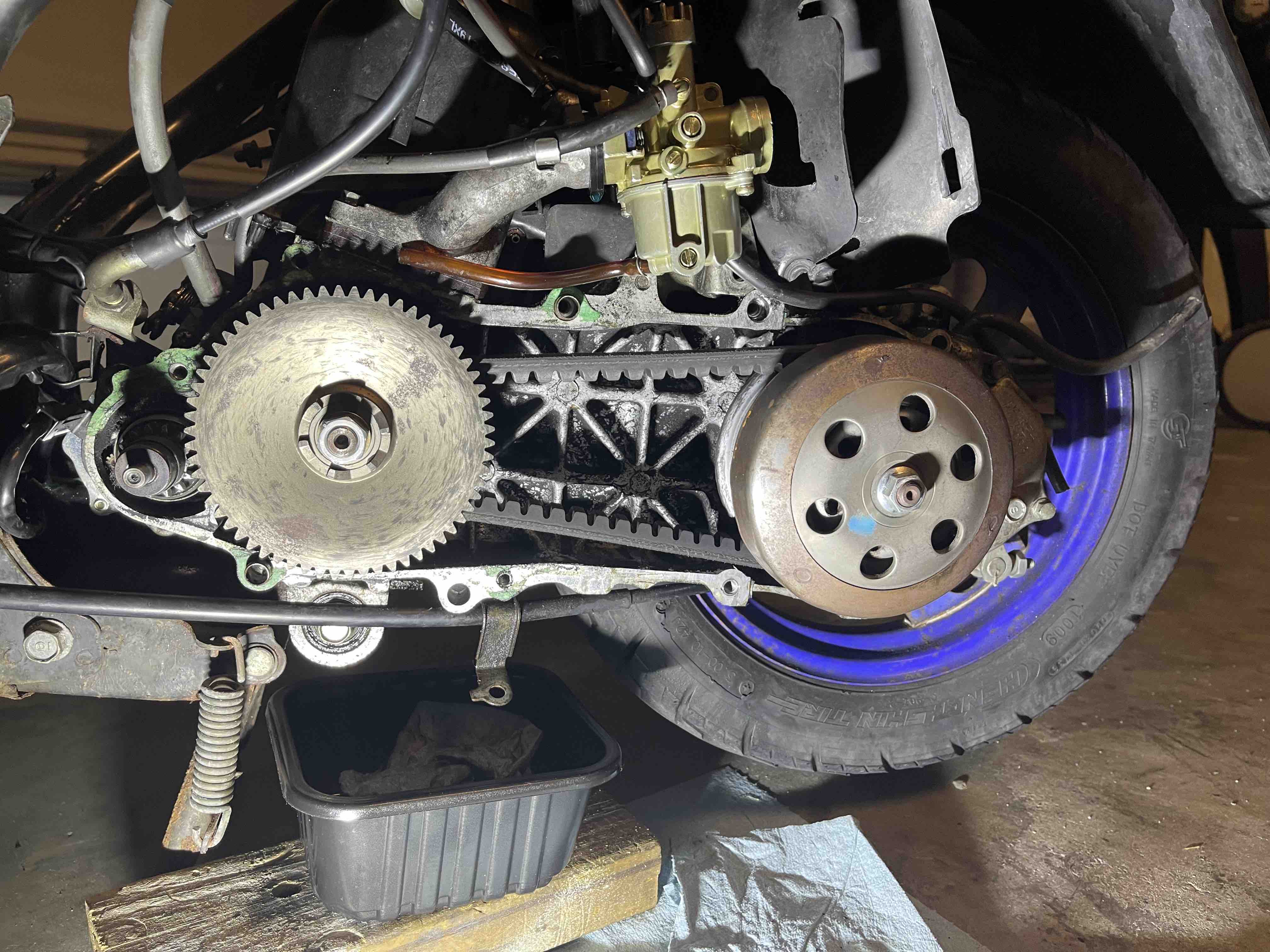

Hi I'm troubleshooting a 1994 SR Elite that has been in a garage for maybe 10+ years or so. I can kick start it and get it fired up, rev the throttle, which shows promise. I did notice that the rear wheel is not spinning when I increase rpms. So I removed the kickstarter covers and can see that the belt is on. (pic attached)
Symptoms
-Spin the belt manually and the rear wheel does not spin
-Spin the driven gear (left) and the belt spins, pinion starter is not engaged ( too recessed to engage with driven gear ), but the rear wheel does spin
-Spin the clutch pulley and only the rear wheel spins
Any ideas or guidance appreciated!
Thanks in advance!

<Correction>
Symptoms
-Spin the driven gear (left) and the belt spins, pinion starter is not engaged ( too recessed to engage with driven gear ), but the rear wheel does NOT spin

Your 3 (corrected) symptoms seem normal for eng OFF. Maybe clutch shoes are stuck in retracted position or RPMs weren't high enough to make clutch engage? Clutch won't engage until RPMs are kinda high.

zz28zz wrote: Tue Jul 18, 2023 12:24 amclutch shoes are stuck in retracted position
This
Remove the bell and use a flathead screwdriver to “slightly” pry up on each clutch shoe. Just enough to break it free from stuck and not over stretch the spring. Good idea to replace the springs if they look rusted together.
