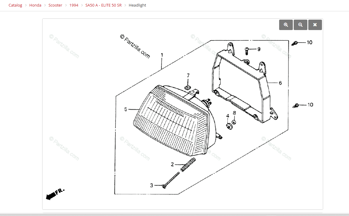

IIRC while the metal ring is a different size for for the 84-86 Spree, 87 Spree/Elite, and 88-94 Elite, the actual glass part is identical between the models.
Part #6 below, which varies between models.
Part #5 in below, which is more or less the same.
LMK. If no part exists for this, I'll draft one up. Sort of a silly thing to not be available anywhere.

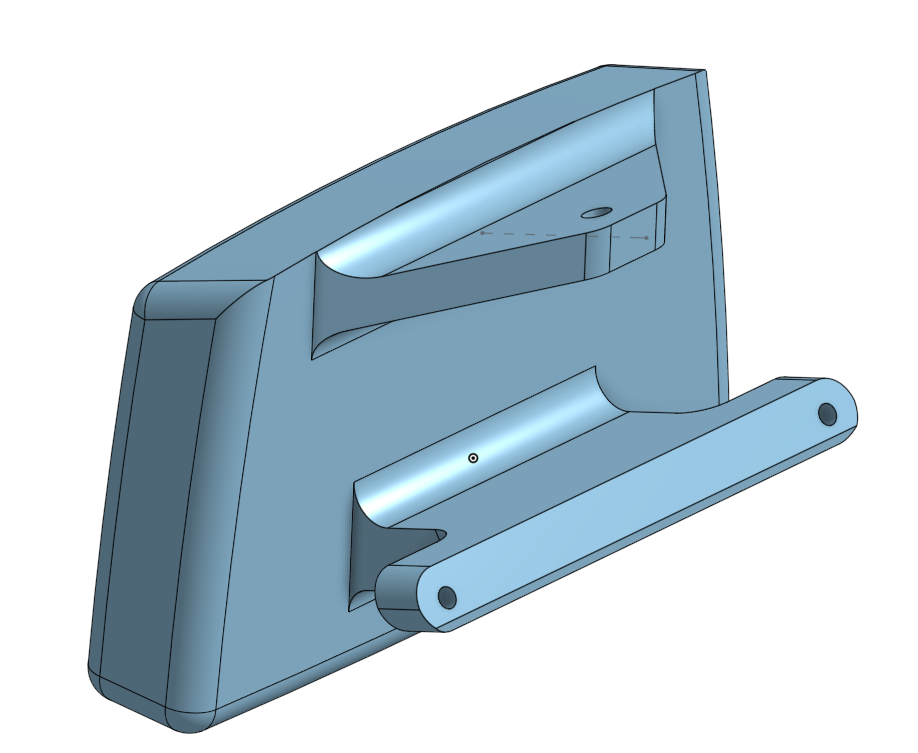

I'm thinking something like this, where it attaches to the top cover and is accessible from the front (vs using the metal framework) and uses an off-the-shelf automotive LED fog light. You'd adjust the light angle by adjusting the angle of the LED element.
It would use way less power than stock (10-15W) but would be a lot brighter than the incandescent bulb ever was.

Meanwhile, this design's close. Need to finish fitting fastener sizes, and work in the LED lamp. There's a few a couple options; hard to tell how they'll work but most modern LED lighting is pretty bright.

Rideslikenacho wrote: Fri Oct 13, 2023 10:40 am My only concern is how tight the space is in there behind the bulb with the wiring and speedo cable.
That's not an issue. The LED modules are flat; the only reason this "bulb" is that size is b/c it uses the existing mounting. I'll PM you the details.
The only downside I see is that there're no Hi/Low beam. The upside is I think it'll be a lot brighter.
