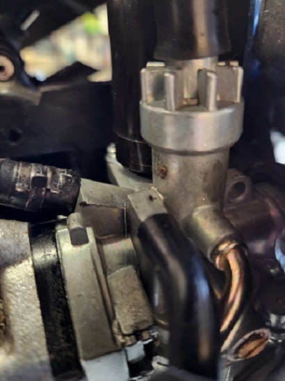

So I installed it.
The main issue was that my throttle cable now had a ton of free-play. Different cap design. Adjusted throttle cable almost all the way out. I toyed with the idea of swapping the Honda throttle slide and enrichener, but eventually left the Chinese ones on. The Chinese needle is considerably thinner than Honda's - another reason to leave it in...The only thing I did swap in was my Keihin 90 main jet. Fortunately, it fit.
Once primed, it fired up. I had to back the throttle stop down, and adjusted the air screw to 1-3/4 turns out from seated. (The Honda had gotten to 5/8 for it to run at all...) Too rainy for a real test ride, but dodging showers down the street and back the bike's "personality" was different. When you ride a scooter several times a week for this long, you can feel the difference. I can describe its behavior as more "Coarse", but it did run pretty well.

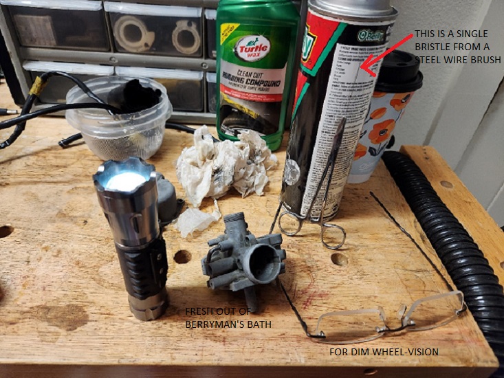

Garage Therapy Sunday saw the Honda PA carb pulled from Berryman Bath.
Getting ready:
I had a plastic tub to minimize mess. No carb cleaner on hand, brake parts cleaner had to do.

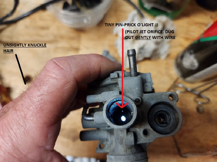

Attention turned immediately to the Pilot orifice - the suspected cause of recent misbehavior.
The surgical clamp holds a single steel bristle pulled from an old wire brush. Even the 1st "E" guitar string is too thick.
Poked and prodded half in darkness until I was able to dislodge whatever felt Sticky in that little hole.
Held over a flashlight, I was able to see this:

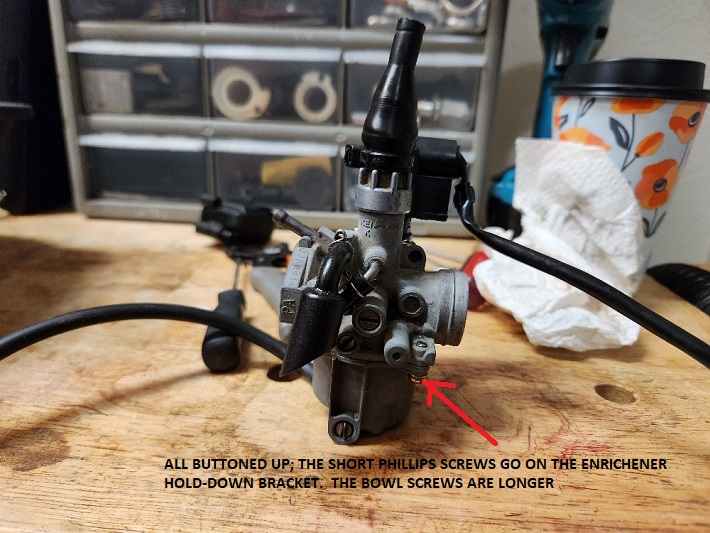

Reassembly was concluded. The longer screws bottom out before they compress the hold-down bracket on the enrichener.
It will be ready to go if (WHEN?!) the Chinese clone PA starts to act up. So far no Gasoline Lake under Flash...
