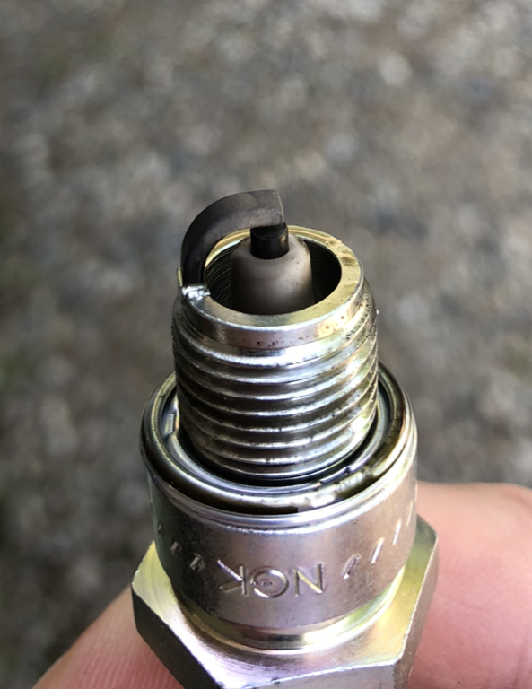

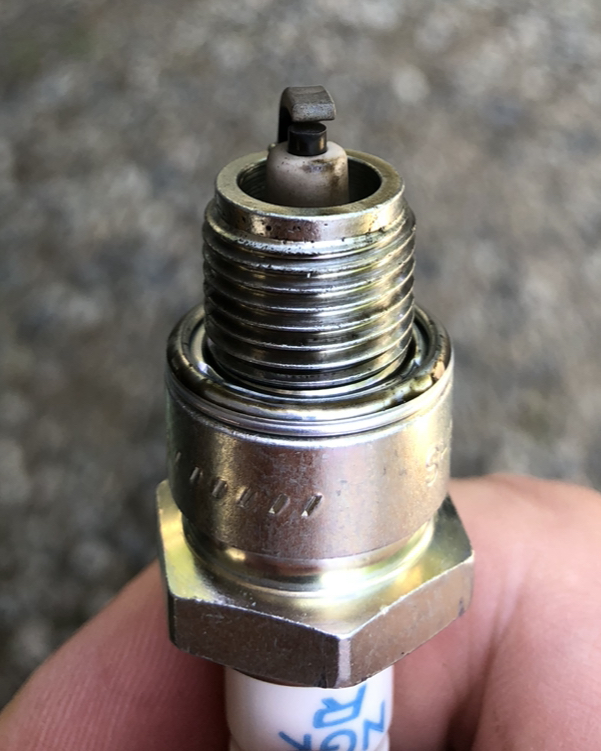

Hey all. 84 Aero 80. Could someone tell me if this plug is just right, or is it lean? Brand new plug out of the box, about 5 minutes of runtime, ripped down the road WOT, turned around, hit WOT again and then parked it and pulled the plug. Unfortunately I have just the one plug along with the old one.

Re: Plug read
Are you suspecting the scooter to be running lean ?
I see nothing on the plug that indicates lean.

Re: Plug read
Hi Mike, no it runs good. There is a slight hesitation somewhere around 1/2-3/4 throttle before hitting a noticeable power band but all in all it runs good. I leaned it out (needle clip 1 setting and also air screw 1/2 turn. Initially using existing plug but it looked wet - hence deciding to start leaning it out ) and it runs a little better maybe. The plug in pic is a result of this. I dont want to find out the hard way that its too lean.
This is on a new polini 21 mm out of the box, larger intake and I also fitted a v8 pipe (off a dio or spree, cant remember) had to cut and weld to make it fit. Not trying to make a rocketship but one thing led to another. Really just like having the cable operated choke. I did not expect to have to lean things out is why i ask.

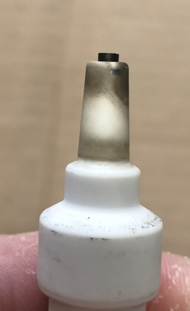

I actually chopped the above plug and this is the pic. I expected the ring to be darker but either it is too lean or not enough run time. Im not sure i can actually perform a legit plug chop on a scooter or maybe i have to run it down the road further? I have ordered a cyl head temp gauge with an eyelet that goes under the spark plug. Still would appreciate any input.

Re: Plug read
Yeah, a legit plug chop on a bike with a clutch means cutting Ignition as you pull in the clutch. On a CVT scooter, the engine keeps spinning after you hit the kill switch, and the unburnt fuel "washes" the plug for at least a few thousand cycles before you pull to a stop and unscrew the plug to read it.
We've learned to "read" the plug despite this. But yours needs a good long ride to be able to say anything more. Your plug basically looks brand-new.
Re: Plug read
Hi Rob, I suggest you test for lean condition this way. Buy a CHT gauge like you said, and you can more easily tell if your carburetor needs a larger or smaller main jet by the temperature reading but it has to be with the ring under the spark plug and you remove the crush-washer first. If you get the temp above 380 and climbing while running down the road, then you need an upjet to next size. 400 is max and if it got that hot it would have shut off by itself soon after that. But check it again and if it still climbs above 380, well, you might have an air leak somewhere. But you said it ran good without any issues? or you didn't suspect you have a lean condition?
On the exhaust, kudos for making it fit! Be sure it is not leaking at the flange! You will know if it is by looking at that connection and see if you see oil all over that area? If so, you better adjust it or re-weld it, or use a different gasket but be sure it doesn't leak! You do not want any leaking at that connection. Then re-test for lean if you had a leak there. I could not tell you anything by the pic of your spark plug. Wheelman said it perfectly.

Re: Plug read
Don't wanna hurt anyones feeling but that plug looks lean to me and I would go up at least 2 sizes in main jets. Oh and I really don't care who's feelings I hurt.
