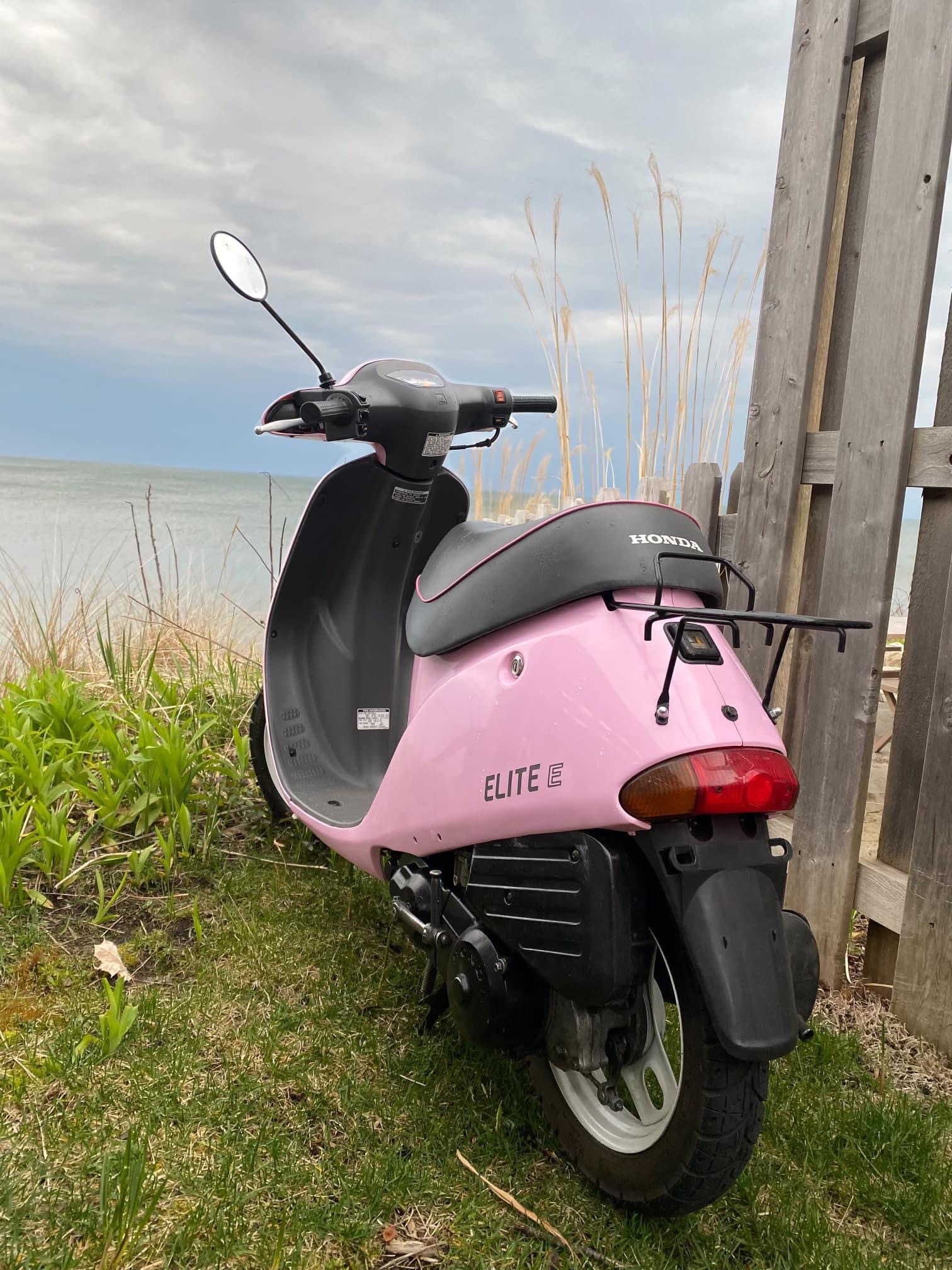

that thing is beautiful! i need me one of those tail lights 🤤. i will post some pics of mine soon but i cant figure it out on my phone.
