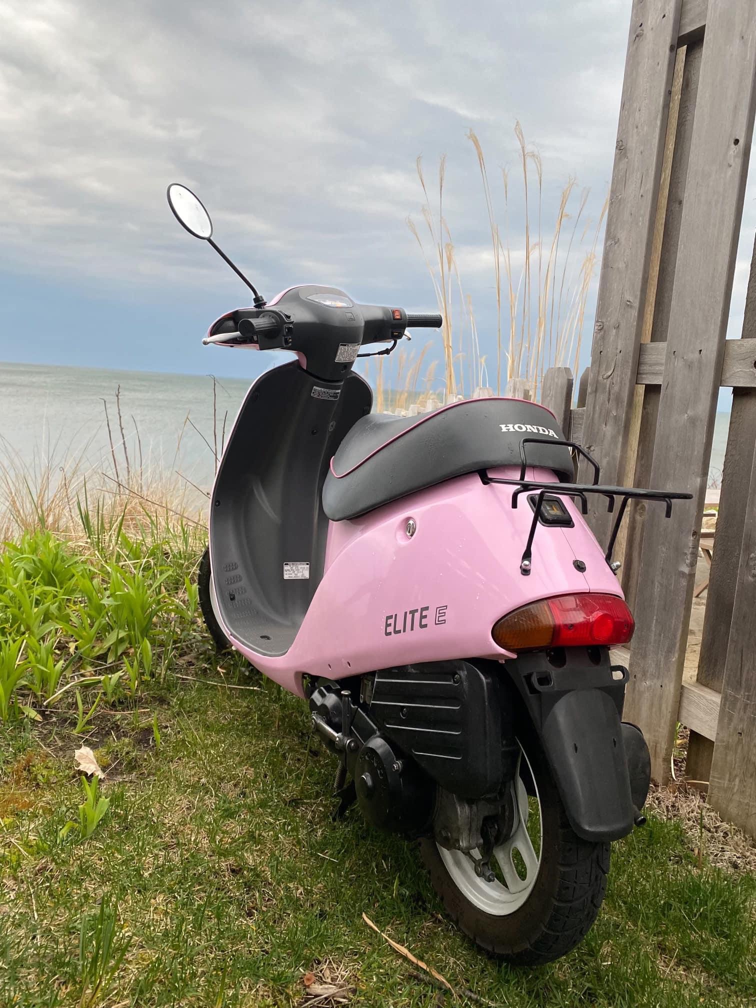

Re: 1988 honda elite sb50p engine swap
Posted: Wed Oct 22, 2025 5:53 pm
by iampee
that thing is beautiful! i need me one of those tail lights 🤤. i will post some pics of mine soon but i cant figure it out on my phone.
