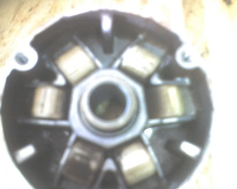

So a couple weeks ago I took off the pulley and removed the plate that restricted the top speed of the moped. While the crank case was off and the pulley was off I looked at the rollers. It appeared that the rollers have flat spots on them from wear and tear. Should I replace these with new onces? What benefits would this give me? It does seem while riding right now it loses it acceleration for a 1/2 second around 25 mph then picks right back up to ~35.
here is a bad picture of the rollers. http://img.photobucket.com/albums/v694/ ... img093.jpg

Flat spots on rollers means it time to replace them, its not a big deal but it makes your take off choppy. after market rollers get flat spots fast, honda OEM is the longest lasting.

flat weights are caused most times from debris or just old worn out parts. Stock Dio motor has 8.5 grams in them. im pretty sure that variator kit has 8.5s in them. Did you try removing your restrictor plate from behind the variator? that alone will give you speed. As for your motor, look on the back of it, somewhere by the gear oil plug you wil find some numbers. What you are looking for is "AF16" thats considered a dio motor..
