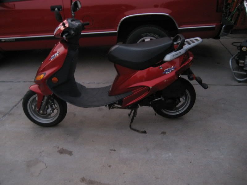

I have an 04 Kymco zx50, which I understand uses the Honda dio engine.
If I had known this before I started the rebuild/modification I would have picked up some better components, but oh well, there's always potential for another scooter in my stable.
I've been a motorcycle rider for seven years, but have wanted a scooter since my mid teens. I finally got one for $20 with a siezed engine. I rebuilt it with some aftermarket and oem parts and absolutely love it so far.
Current Mods:
OEM Crank and bearings
Airsal Cylinder and Piston 70cc
Arreche Carb 19mm w/#80 main (this may be causing problems..)
Technigas expansion chamber exhaust
1500rpm Clutch springs
Stiffer torque spring
7g roller weights in stock variator
My only issue that I have with it (while it ran well) is that my top speed is limited to 37-38 mph. I'm using it for commuting mainly, and two of the roads I travel for a total of 4 miles, are 45mph speed limits. The remainder are 20-35 with the majority being 35mph.
The CDI is still restricted, I can derestrict it with a simple scotchlok connector, but for engine life I think I should leave it alone. I made another post, and was recommended a gear kit, so that's on the list of future mods.
I'm still on the original intake manifold (12.5mm w/ a 19mm carb) which I believe is causing issues. What parts should I look into for changing out the intake side? I'll be honest, I know nothing about scooters. I have alot of experience with 4 stroke carb'd and FI motorcycles, but nothing 2 stroke, and no scooters.

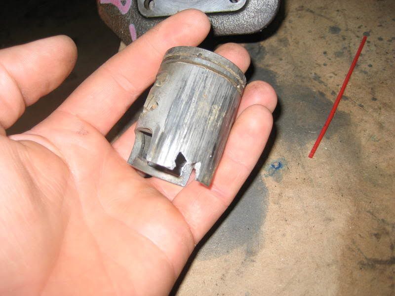

My oil mixture pump is shot. This is what caused engine failure for the previous owner. I don't know how much a replacement is, still waiting to hear back from the dealer. However, being that it's a standard dio engine I think I may just pick up a used one for much less. The question is, do I trust that pump? Or do I premix? This leads into the next question
My #80 main jet. This may be the source of what ails me currently. I tuned the engine through plug readings alone. Everything seemed to be fine, I had to move the needle down one clip, but other than that it was great. I started out on two tanks of 50:1 conventional 2 stroke oil. After a 45 mile trip I decided I could switch to 30:1 synthetic. I mixed 4fl oz of mobil 1 2 stroke racing synthetic oil to one gallon of 93 oct. After that it never ran right. I was having problems prior to that, but they increased after switching the fuel. My thinking is that it's possible after reading other's ideal setups, that my main is too small and by increasing the viscosity of the fuel, everything got messed up.
Before I knew the oil pump was shot, I decided to give it a try after having the above issues. I hooked it up, put oil in the lines, fresh fuel in the tank, cleaned the carb out and started it up. Engine fired right away no problems, revved beautifully, but when I pulled off the output line from the oil pump, there was no flow, even when I manually opened the oil pump valve. I immediately shut the engine off (less than a minute runtime w/o oil).
Basically where I'm at now is that I want to increase my top speed, and get her to run right either with a mixing pump or premix, doesn't matter to me. Premix would be cheaper without a doubt, but what it looks like to me is that premix is too heavy to be drawn through the carb and intake properly. If this is the case, would replacing the intake manifold/reed valves to match with my intake make up for this?
I can justify spending as much as the scooter will save me over the summer which I have calculated to be $1080. I'm $750 into it, so I don't want to spend more than another $350 to finish if at all possible, but that's not to say I'm not willing to spend more. Basically whatever it takes at this point, I'm too deep into it to put a small cap on.
So my main question is where do I go from here?
1.) Gear kit
2.) Intake manifold? Reed valve?
3.)???
4.)???
Sorry for the rambling post, hope it makes sense to somebody and you can give me a hand.

A picture of it as it sits. I'm going to put the plastics back on, but cut them back to only cover the tank/electrical and hug the frame down to the floor, and trim down the fender, installing a tire-hugging fender instead and paint everything bbq black or chalkboard green, there's no saving the plastics and I'm not going to replace them.
Here's where I started, locked up engine, looks like it had never been oiled
