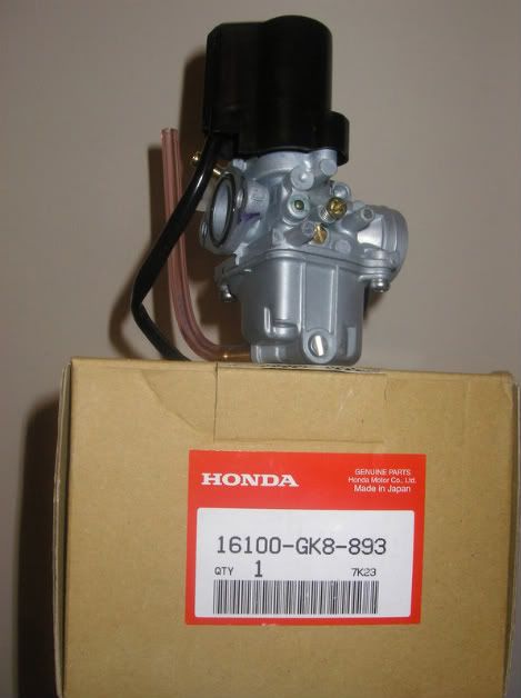

After cleaning the carb several times and eventually breaking the pilot tube when trying to remove it, I broke down and bought a BRAND FREAKIN NEW one! Interestingly enough hondapartsdirect.com said it wasn't available and servicehonda.com wouldn't answer my emails. Got this one from discounthondaparts.com for $125.79 plus shipping and it included a NEW BYSTARTER! Here's a pic to prove it's real.

HOLY s***!!! I have never seem one so clean, mine is a sort of yellow color and covered in a mix of oil and dust.

Wow. I started to clean mine up, but I thought that it was supposed to be yellowish :shock:

Wow so much money for a stock carb.. :shock:

Looks like I will need to by one of those . I am so sick and tired of trying to get my spree to start when its cold. I bought my Spree without a bystarter. What was your results? Did you have to make any adjustments or was it plug and play?

The new carb showed up today. It looked exactly like yours, Honda box and all. The only thing I had to modify was the wire connection for the bystarter. I hooked it up completly dry and new. Whats amazing is it started right away as if it had fuel in the carb already. No adjustment needed. My little spree runs just like a new one now!!! The only thing left is waiting for the Kenda tires to arrive and trying to figure out why the oil light comes on even though the oil tank is full.

that thing is prime great picture im polishing mine up
