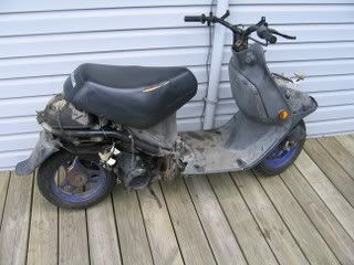

here it is after i stripped all the body panels and lights/dash off.
can someone please tell me they didnt come with purple wheels from the factory. hahah.

mopedman
Posts: 1213
Location: sterling Heights MI
Post by mopedman »
i think they came on some of them

mopedman
Posts: 1213
Re: 1994 Elite SR. Complete rebuild help?
Post by mopedman »
some came with the rims i ment
