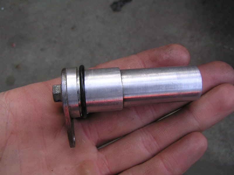

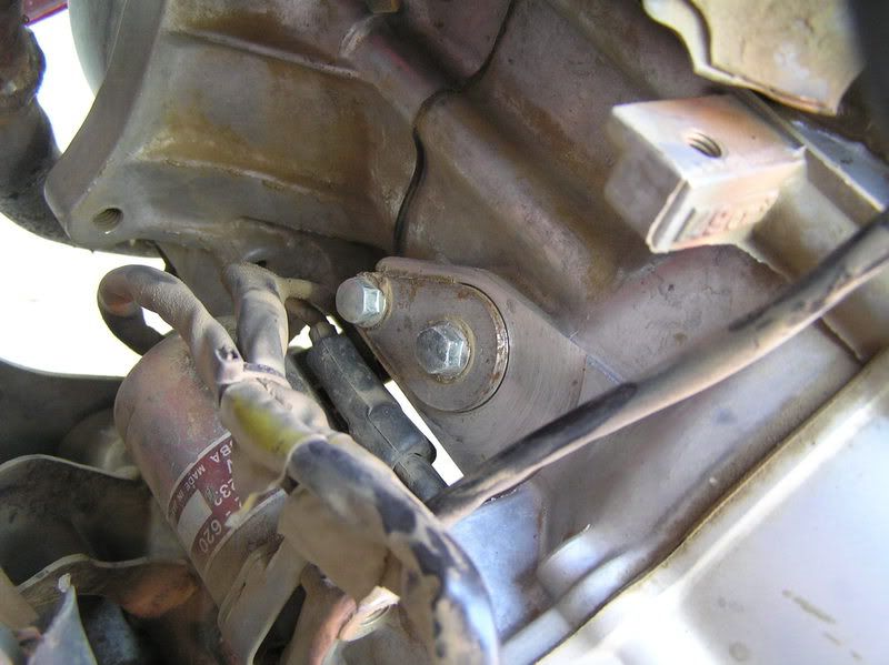

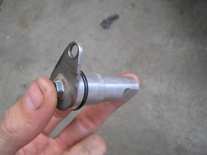

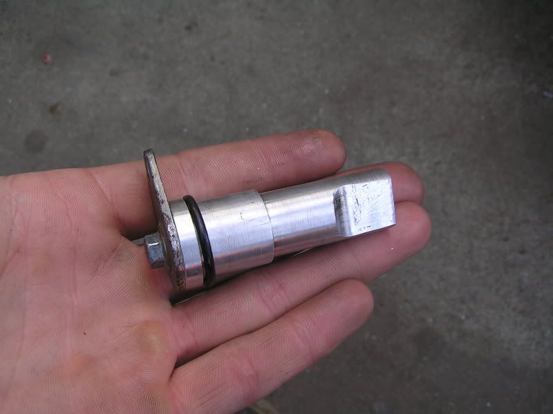

im getting a camera today, ill get pics of mine...i machined a piece of aluminum to replace the pump, its also a crankcase stuffer.

Take a look at pics farther down about half way, I have two that show the aluminum stuffer plug I used from VT Cycles.
This is done to solely run premix, usually when going to big bore kit.

Pics per scooterwerx, accidentally split your post mate. His post:
here is my little stuffer....
