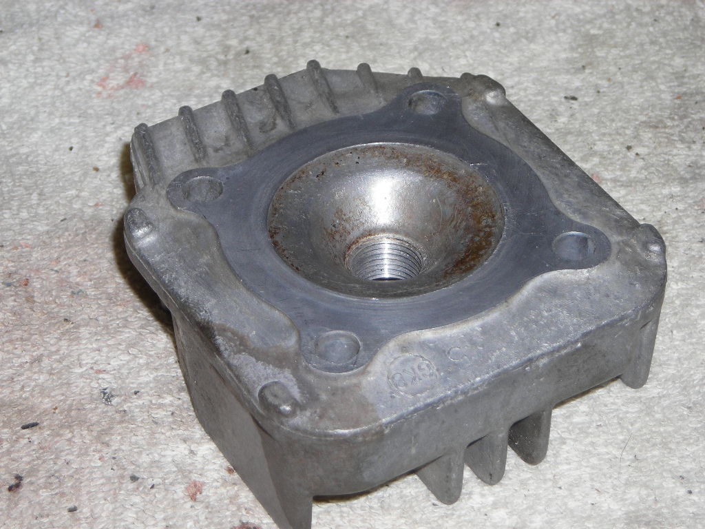

Just cut a Spree head to raise the compression for better performance. Here are some pictures.
http://datsunroadsterranch.com/scooter/headcut1.jpg
http://datsunroadsterranch.com/scooter/headcut2.jpg
Here is a stock head. Note the small step at the edge of the combustion chamber. This step is about .020". This is the reccomended maximum cut.
http://datsunroadsterranch.com/scooter/headcut3.jpg
Chucked it up in the lathe, centered and squared it. This can also be done on a mill.
http://datsunroadsterranch.com/scooter/headcut4.jpg
Time to cut.
http://datsunroadsterranch.com/scooter/headcut5.jpg
.020" removed.
http://datsunroadsterranch.com/scooter/headcut6.jpg
Layed some 320 grit wet and dry on the drill press table. This is used to remove the tool marks and make sure that is completly flat.
http://datsunroadsterranch.com/scooter/headcut7.jpg
http://datsunroadsterranch.com/scooter/headcut8.jpg
Note the little step is now gone. If you want to cut more off you need to watch for piston interferance.
http://datsunroadsterranch.com/scooter/headcut9.jpg
Stamped the amount cut off to prevent future confusion.
