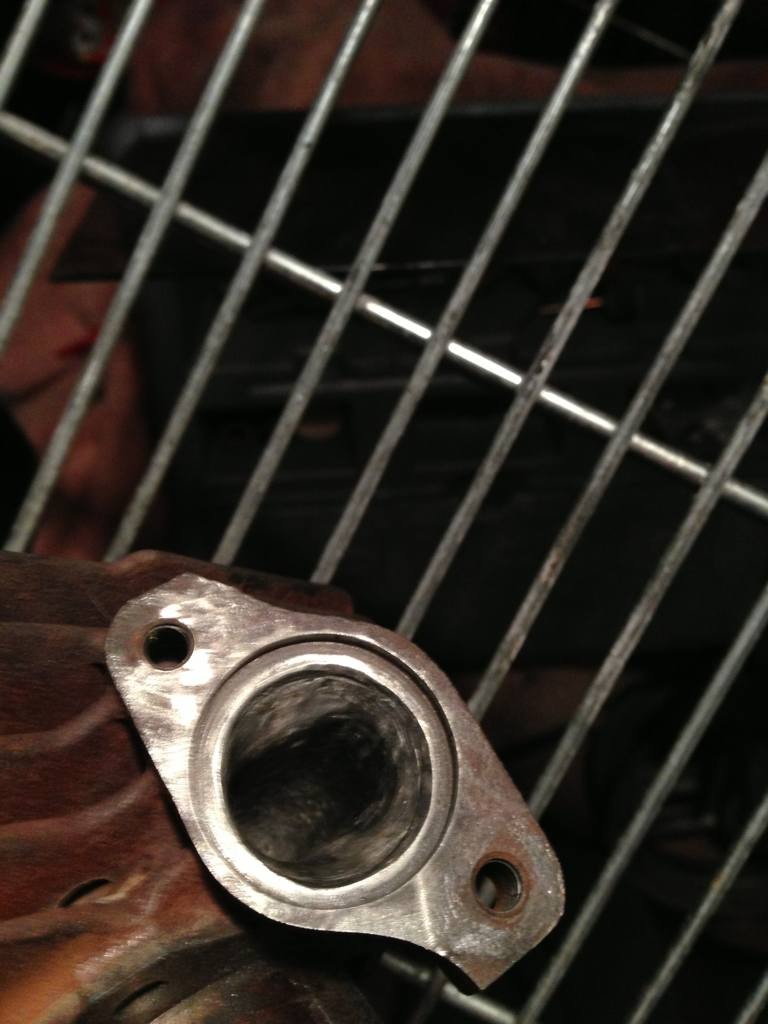

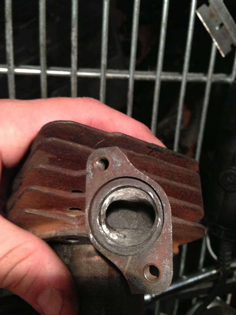

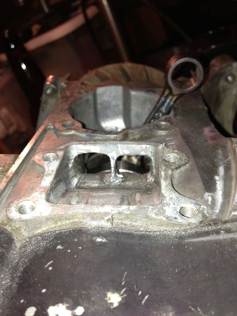

I made a plate today in anticipation of the carb showing up today was about right but a little thin on the outer edge. Should just wayside for it to get here. I will be making another I'm the morning.
Couple pics of my port job as well only my second go at it so take it easy lol.
Thanks guys

Before shot
Did the exhaust port of my stock cylinder jug also.

by Wingnutz
Wow curt looking pretty good! Now you just need to pull the trigger on that replacement metrakit piston and you will be ready to rip.
