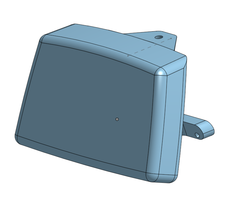

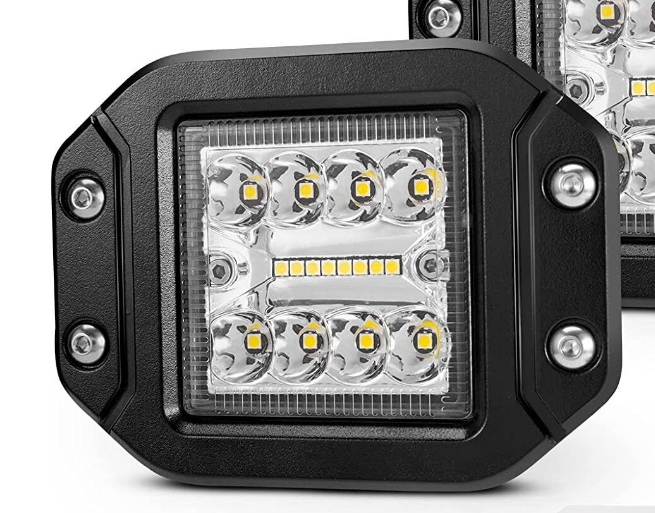

I'm thinking something like this, where it attaches to the top cover and is accessible from the front (vs using the metal framework) and uses an off-the-shelf automotive LED fog light. You'd adjust the light angle by adjusting the angle of the LED element.
It would use way less power than stock (10-15W) but would be a lot brighter than the incandescent bulb ever was.

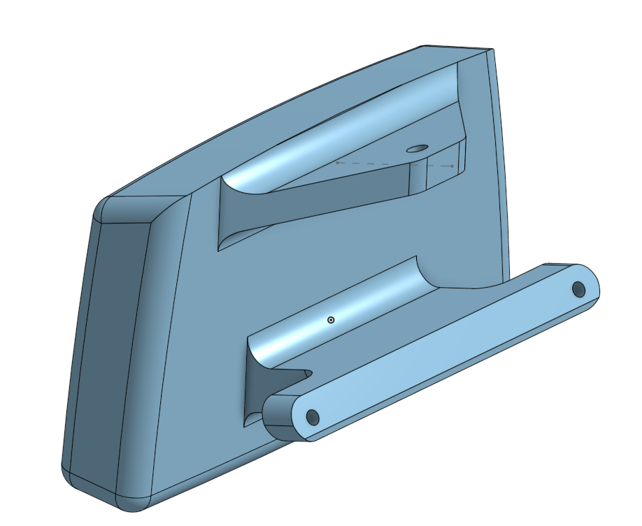

Meanwhile, this design's close. Need to finish fitting fastener sizes, and work in the LED lamp. There's a few a couple options; hard to tell how they'll work but most modern LED lighting is pretty bright.

Rideslikenacho wrote: Fri Oct 13, 2023 10:40 am My only concern is how tight the space is in there behind the bulb with the wiring and speedo cable.
That's not an issue. The LED modules are flat; the only reason this "bulb" is that size is b/c it uses the existing mounting. I'll PM you the details.
The only downside I see is that there're no Hi/Low beam. The upside is I think it'll be a lot brighter.
